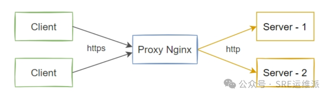

4.5 综合案例
实现 http 自动重定向至 https,并将客户端 https 请求通过负载均衡的方式反向代理到后端的多台 http 服务器上
# upstream 配置upstream group1 {  server 10.0.0.210;  server 10.0.0.159;}
# http 重定向到 httpsserver {  listen 80;  server_name www.m99-josedu.com;  return 302 https://$server_name$request_uri;}
# https 配置server {  listen 443 ssl http2;  server_name www.m99-josedu.com;  ssl_certificate /usr/share/easy-rsa/pki/www.m99-josedu.com.pem;  ssl_certificate_key /usr/share/easy-rsa/pki/private/www.m99-josedu.com.key;  ssl_session_cache shared:sslcache:20m;  ssl_session_timeout 10m;
  location / {    proxy_pass http://group1;    proxy_set_header host $http_host;  }}
#客户端测试[root@ubuntu ~]# curl -Lk www.m99-josedu.com10.0.0.159 index
[root@ubuntu ~]# curl -LkI www.m99-josedu.comHTTP/1.1 302 Moved TemporarilyServer: nginxDate: Sat, 17 Feb 2025 13:55:01 GMTContent-Type: text/htmlContent-Length: 138Connection: keep-aliveLocation: https://www.m99-josedu.com/
HTTP/2 200server: nginxdate: Sat, 17 Feb 2025 13:55:01 GMTcontent-type: text/html; charset=utf8content-length: 17last-modified: Wed, 14 Feb 2025 02:45:15 GMTetag: "65cc293b-11"accept-ranges: bytes
