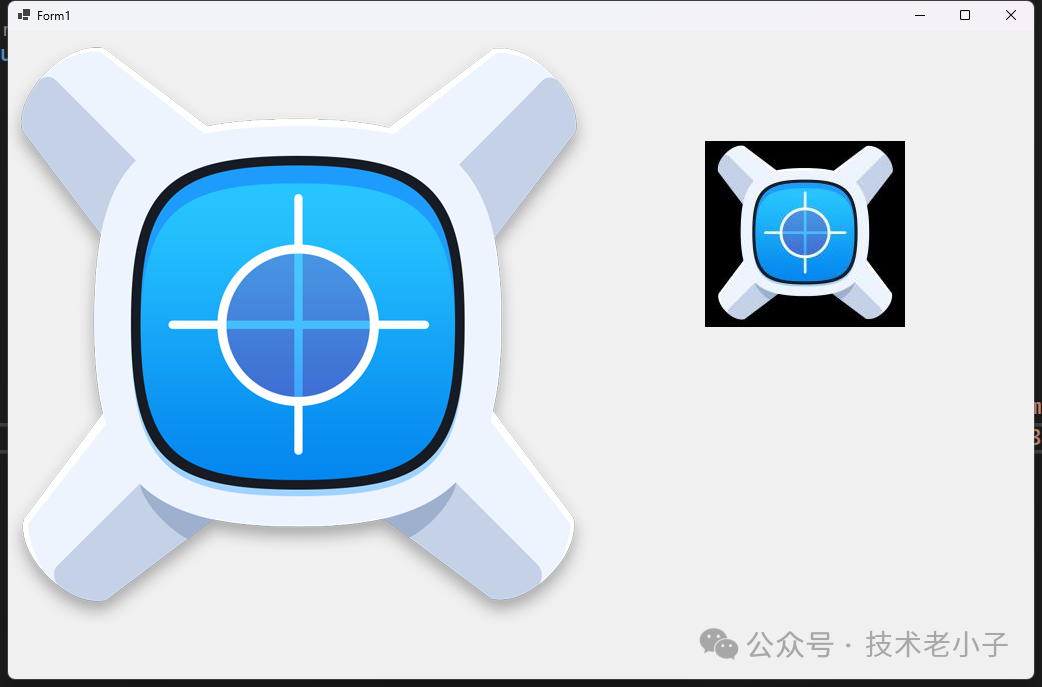

ThumbnailGenerator thumbnailGenerator = new ThumbnailGenerator();
thumbnailGenerator.GenerateThumbnail("D:\\BaiduSyncdisk\\11Test\\promo.png", "D:\\BaiduSyncdisk\\11Test\\promo3.png", 200, 200);
pictureBox2.Image = Image.FromFile("D:\\BaiduSyncdisk\\11Test\\promo3.png");
